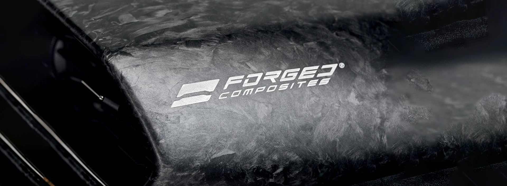

I want to make this kind of material proceduraly but that’s not so easy.

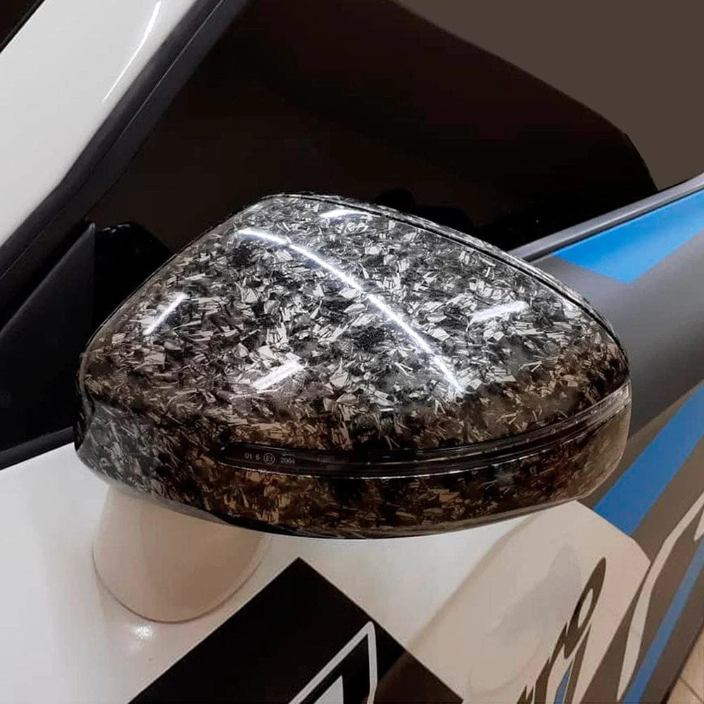

I used this image of a Lamborghini mirror as base, personally I like matte looks better in general for composites but the gloss layer would be the least problem I think.
